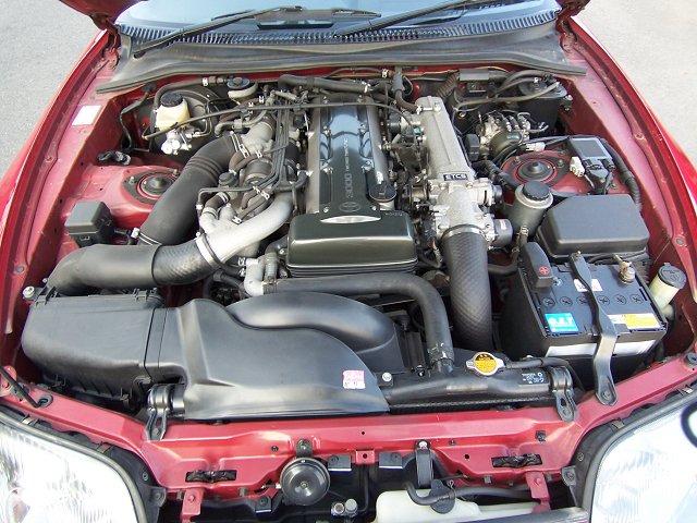

View into J-Spec Engine Room

Description:
1: Exhaust Gas Recirculation
2: TRAC-Pump, builds up pressure in ABS-System
3: Series Resistor for Injectors
4: Writing on throttle body (Export: "TRACTION CONTROL" J-Spec: "ETCS" = "Electronic Throttle Control System")
5: Cruise Control Control Unit (can be available in J-Spec vehicles)
